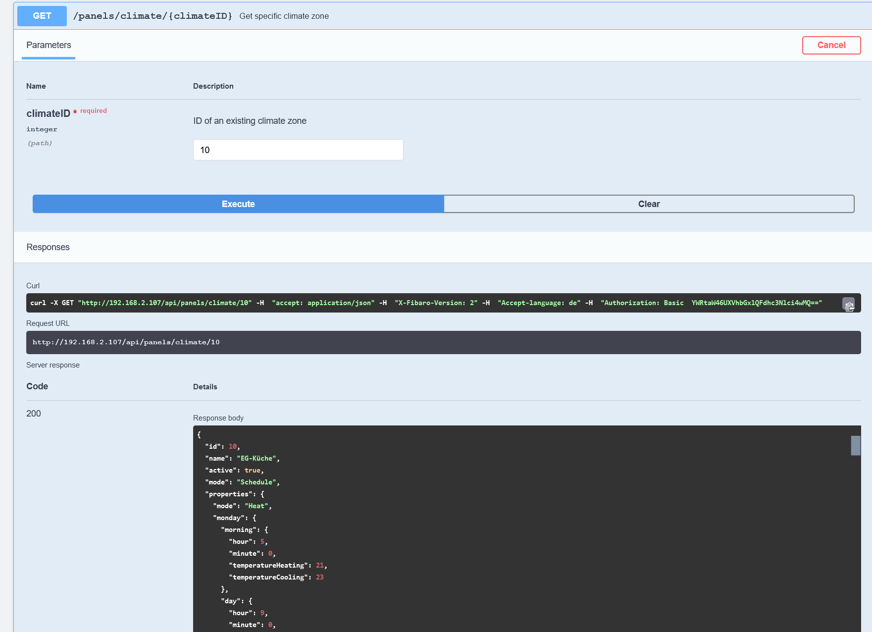

Ja kann man mit api.get und opi.put.
Schau im Schwagger nach !
Hier mein Eintrag für ID10 !
  "id": 10,
  "name": "EG-Küche",
  "active": true,
  "mode": "Schedule",
  "properties": {
    "mode": "Heat",
    "monday": {
      "morning": {
        "hour": 5,
        "minute": 0,
        "temperatureHeating": 21,
        "temperatureCooling": 23
      "day": {
        "hour": 9,
        "minute": 0,
      "evening": {
        "hour": 17,
        "minute": 0,
      "night": {
        "hour": 22,
        "minute": 0,
        "temperatureHeating": 16,
        "temperatureCooling": 20
    "tuesday": {
      "morning": {
        "hour": 5,
        "minute": 0,
      "day": {
        "hour": 9,
        "minute": 0,
      "evening": {
        "hour": 17,
        "minute": 0,
      "night": {
        "hour": 22,
        "minute": 0,
    "wednesday": {
      "morning": {
        "hour": 5,
        "minute": 0,
      "day": {
        "hour": 9,
        "minute": 0,
      "evening": {
        "hour": 17,
        "minute": 0,
      "night": {
        "hour": 22,
        "minute": 0,
    "thursday": {
      "morning": {
        "hour": 5,
        "minute": 0,
      "day": {
        "hour": 9,
        "minute": 0,
      "evening": {
        "hour": 17,
        "minute": 0,
      "night": {
        "hour": 22,
        "minute": 0,
    "friday": {
      "morning": {
        "hour": 5,
        "minute": 0,
      "day": {
        "hour": 9,
        "minute": 0,
      "evening": {
        "hour": 17,
        "minute": 0,
      "night": {
        "hour": 22,
        "minute": 0,
    "saturday": {
      "morning": {
        "hour": 7,
        "minute": 0,
      "day": {
        "hour": 9,
        "minute": 0,
      "evening": {
        "hour": 17,
        "minute": 0,
      "night": {
        "hour": 22,
        "minute": 0,
    "sunday": {
      "morning": {
        "hour": 7,
        "minute": 0,
      "day": {
        "hour": 9,
        "minute": 0,
      "evening": {
        "hour": 17,
        "minute": 0,
      "night": {
        "hour": 22,
        "minute": 0,
    "handSetPointHeating": 8,
    "handSetPointCooling": 22,
    "handTimestamp": 0,
    "handMode": "Heat",
    "vacationSetPointHeating": 18,
    "vacationSetPointCooling": 26,
    "vacationMode": "Auto",
    "vacationStartTime": 0,
    "vacationEndTime": 0,
    "currentTemperatureHeating": 21,
    "currentTemperatureCooling": 23,
    "currentSetpointTimeStartHour": 9,
    "currentSetpointTimeStartMinute": 0,
    "currentSetpointTimeEndHour": 17,
    "currentSetpointTimeEndMinute": 0,
    "devices": [
      204
    "incompatibleDevices": [
      204
  "created": 1609919997,
  "modified": 1609919997
Hier der Dazugehörige Eintrag !
Jetzt noch etwas rumprobieren und erledigt !
Wenn ich eine Szene aktivieren oder Deaktivieren möchte mache ich das so !
api.put(„/scenes/“..176,{enabled=false})
fibaro.sleep(10000)
api.put(„/scenes/“..176,{enabled=true})
So als Basis für deine Versuche gedacht.
Gruss Frank
