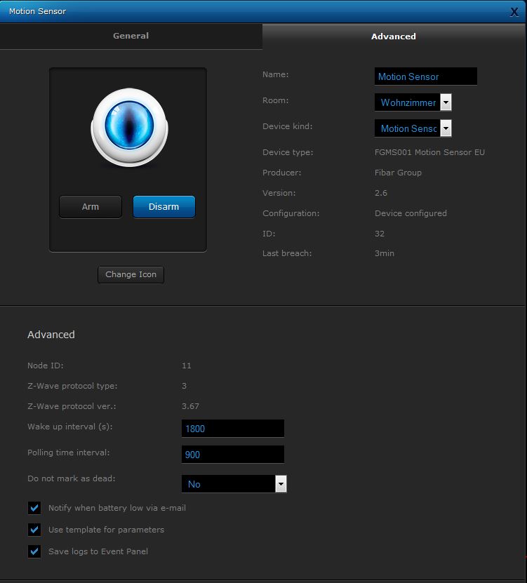

Kann mit bitte jemand kurz erklären, was im Fibaro Motion Eye eine Polling Zeit von „0“ bedeutet? Ich habe versucht in der Bedienungsanleitung einen Hinweis zu finden, aber das war erfolglos!
Danke im Voraus!
Gruß Det

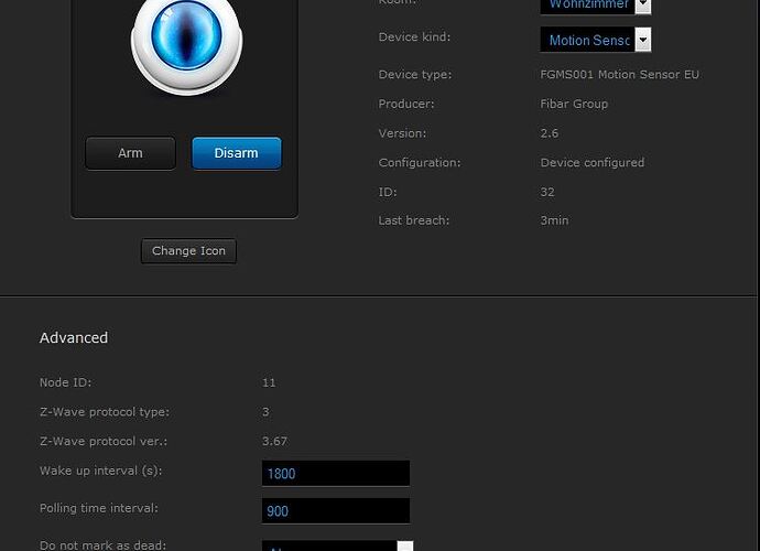

Hi Alex, Hi Hoogle
ich nutze die HCL! Der Motion Sensor hat unter Advanced Settings diese Option! Default Wert ist „0“! Ich habe den Wert auf 900 erhöht, in der Annahme, dass ich jetzt jede viertel Stunde neue Werte erhalte!
Die Wakeup Time wird separat angegeben. Das ist es ja was ich nicht verstehe! Wo liegt der Unterschied?

Polling interval
This is the time between „polls“ and a poll is the controller asking for the device to send information. Only mains powered devices have their radio switched on at all times, so they can respond to this request whenever the controller asks. But what with a battery device? If the controller ask something while the device sleeps (and that’s almost always), it can’t receive the poll. I don’t know how Fibaro implemented it, but there are 2 possibilities: either the poll is queued or it is discarded. There is a hint how it’s done: have you looked at the interface lately? Then you have noticed that a battery device does not have the „polling“ settings. In my own opinion, polling indeed doesn’t apply to battery powered devices.
What should we do with polling? Is polling necessary? First of all, I remember cases of users that where unhappy without polling, as it was disabled in the earlier 4.X versions. I once owned a device myself, that did not report status to the controller: a simple switch. No polling means: the controller doesn’t know the state of the switch when operated locally. But if you have a look at the technical documentation of your device, you’re likely to find a „reporting group“. And if it’s Z-Wave plus, having such a group is part of the standard. That means the device sends data to the controller, when something interesting happens.
What’s the issue with polling? Polling causes network traffic. And that may introduce delays from and to your devices. It depends on network size, network design, code and device types. I have 37 mains powered devices (43 battery), and I can tell the difference between polling on and off. The polling traffic is very likely unnecessary traffic. I would disable polling. If HC2 is wrong about the status of a device, verify if „1“ is in the reporting group (see device manual). To my knowledge, none of the Fibaro devices need polling.
One more thing. The „polling“ and „wake up“ interval can be put on the same report, in the same column, because they cannot occur together. If it’s a battery powered device, it can’t be polled because the device switches off its radio when it’s sleeping. And when it’s a mains powered device, its radio is always on, so „wake up“ doesn’t apply.
